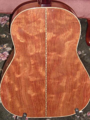

Jim here's one I made. It's a slope shoulder dred.

Sure wish I had more of that Waterfall Bubinga

WOW WOW WOW ...... REWOW BOB, That's a fantastic one!

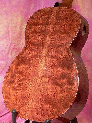

Jim, here's one I've posted before, and bear with me everyone for doing so again.
It's the only Bubinga guitar I've built, and I think it was my best effort. The stuff is an excellent choice for backs and sides.
PostPosted: Mon Apr 03, 2006 6:01 am
Steve I've seen that picture many times and I still enjoy looking at it. Beautiful guitar.
PostPosted: Mon Apr 03, 2006 7:24 am
Steve, please feel free to post that picture anytime. It makes me drool just looking at it. (as close as I could come to a drooling smiley face)

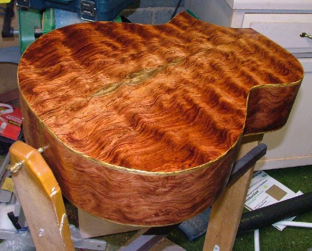

Here's another Bubinga guitar. This one is in progress, having just been coated with epoxy. This set is from Brian Hawkins at Beach Tonewood:

Dave, my knowledge of bending guitar sides is truly vast, and yet thinking back over the years and all of the sides that I have bent, I calculate that exactly half of all the sides I have bent were figured Bubinga. Er, well, I... OK, OK, now the truth: I have bent 2 sets of sides; one set was the figured Bubinga shown in this thread. I used a silicone heating blanket on a solid form, wrapped the Bubinga in wet paper, blue spring steel above and below, very little water, and about 315°F bending temp. When I was done, I thought I had faceting, but it was an optical illusion created by the curls. It came out smooth.
The cutaway portion of the bending form I made was not well thought out, and I had LOT of trouble keeping my cutaway caul in place. That fidgeting caused me to keep the sides in the bender at 315° at least twice as long as I had planned, and I scorched the sides in a couple of spots. It all sanded off. I mention that because I think that's another positive attribute of Bubinga. If it had been Maple or many other species, I think it would have been toast.

PostPosted: Tue Apr 04, 2006 9:10 am
The lower bout on that is pretty sweet looking Dennis .. did your wife/girlfriend/nextdoorneighbour pose for that one or WHAT !!!!!
